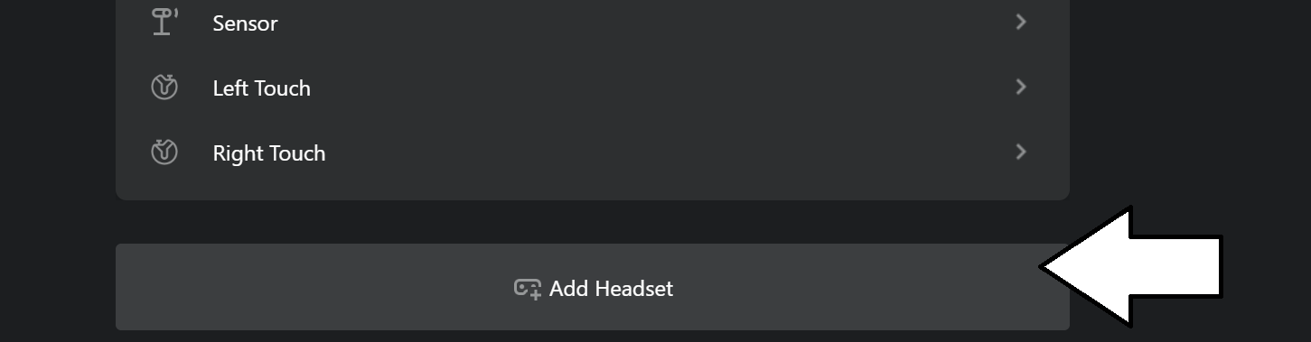

In Oculus, click on “Add Headset” and add the Quest, following the instructions that appear.
