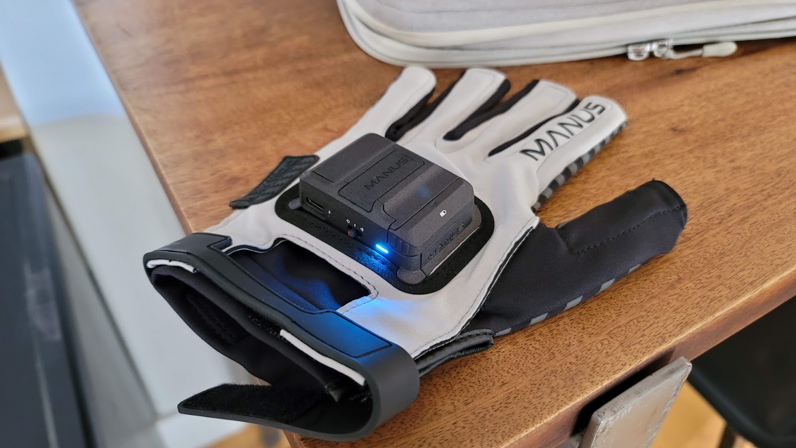

Steps to get running:
  1. Plug in USB Manus VR dongle. When you receive your Manus VR Gloves they are already paired with the provided dongle.
  2. Place batteries in gloves
  3. Turn on gloves by pressing power button (making sure they are charged). Note: If they are not on, Vizard will display an error message.
  4. Run The Manus Core software to calibrate and check data
  5. To calibrate, press the calibrate button, select right or left hand and follow the prompts
To use the Manus gloves with a vivetracker (most common method), select the “HTC Vive” preset in vizconnect, and then swap out the two hand controllers with Vivetrackers. Next, add “Manus VR” as an input. Lastly, you can map gestures in the Avatar tab to the Manus glove and then, under the tools tab, map the Manus gestures to initiate tool actions (such as a grab). Or use the sample vizconnect file provided. For information on Manus VR's updated SteamVR trackers see this page
