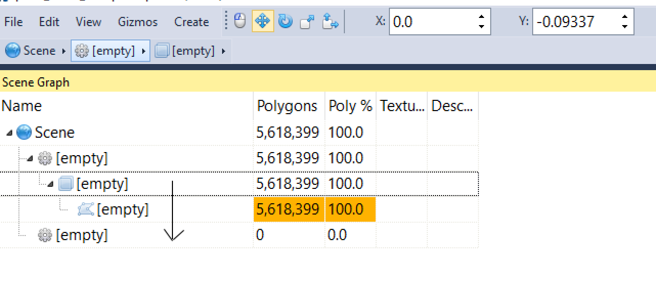

After opening up Inspector, go to File- Open and navigate to where you saved your point cloud file. One benefit of saving out to Vizard OSGB format is it's binary and will load much faster than do text formats.
In Inspector you can use the Translate, Rotate and Scale tools to manipulate your point cloud.
Create a new “Transform” instance by going to the Create tab in the toolbar and selecting Transform.
From there, drag and drop the original point cloud file into the Transform instance.

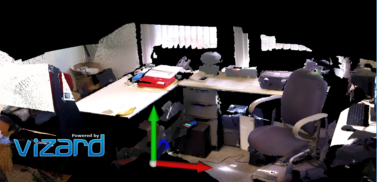

To match up the point cloud with Vizard’s point of origin in inspector you can reference the axis seen here:
For an easy way to visualize the point of origin in inspector, add an object (such as a ball) from the Vizard resources folder by going to File- Add and navigating to (C:\Program Files\WorldViz\Vizard5\resources). The added model will import located at the origin. Once the additional object is loaded, you can move the point cloud to match the location of the origin by using the Translate and Rotate tools.

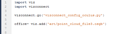

You can import the new point cloud into Vizard using the standard viz.add command. (where “art” is the location of your resources folder)
To help in matching up the point cloud to the origin in Vizard you can show the axes by using the following command:
import vizshape
vizshape.addAxes()

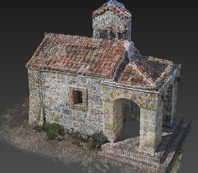

Point clouds with millions of points might be too heavy to render in real-time and therefore aren't usable for virtual reality applications. There are several ways of optimizing the content. Most efficiently, you can remove a certain amount of points without losing detail. Vizard can support a couple million points, exact numbers depend on hardware, display output, and other factors. Below are some tools that can be used to optimize your point cloud.
Point clouds with millions of points might be too heavy to render in real-time and therefore aren't usable for virtual reality applications. There are several ways of optimizing the content. Most efficiently, you can remove a certain amount of points without losing detail. Vizard can support tens of millions of points points viewed simultaneously at full VR frame raters (e.g., 60Hz or higher). The exact numbers depend on hardware, display output, and other factors. Below are some tools that can be used to optimize your point cloud.
To optimize and mesh point clouds you can use a third party programs, such as CloudCompare, Autodesk ReCap, Autodesk Memento, or MeshLab. If you are using the DotProduct scanner, the included application Phi3D will automatically optimize the point clouds for you. If you do require a meshed model, turning to one of the above mentioned tools will get you there.
