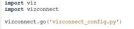

    6. To add to your Vizard scene, add the following code to your Vizard script:

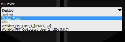

  1. Connecting to Vizible
    1. To connect to Vizible, simply choose the “Oculus Touch” preset from the list of dropdown presets in the client interface (Note: that the “Oculus Touch” preset will still recognize the Rift S controllers).
