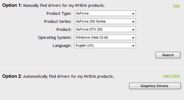

You should first install the latest driver before proceeding. The following link will take you to the main nVidia drivers download page. Then either manually or automatically search to download the latest graphics drivers.
http://www.nvidia.com/content/drivers/drivers.asp

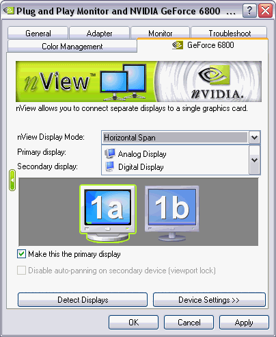

If you see the Digital Display as the secondary display as below, this means that the nVidia card has detected a digital display device. You will need to make the graphics card display to analogue on the secondary display. To do this you must complete the steps that follow below:
hardware_faqs_nvidia_setup3
To change the secondary output from digital to analogue, connect the digital port on the computer's graphics card to an analogue monitor via a 'digital to analogue' dongle. Then close the nVidia utility and go back to the Display Properties window. You should then go to Settings and Advanced to re-open the nVidia user interface. Select Horizontal Span again. As shown below, the secondary display should now show the analogue monitor. If not, try clicking 'detect displays'. Click Apply, click OK to save your settings.
hardware_faqs_nvidia_setup4
THEN, after checking horizontal span and clicking OK, you’re screen settings window should look like this:
hardware_faqs_nvidia_setup5
Notice the really wide left monitor (#1) icon. This is exactly what you want to see. Also notice that the right monitor (#2) is greyed out. That is also what you want.
At this point you can disconnect the analogue monitor and reconnect the HMD cable that was connected to the 'digital to analogue' dongle on the computer's digital graphics card output.
